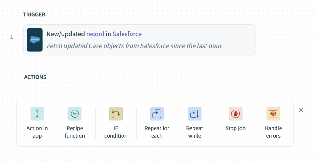

Create a new recipe with Salesforce as the triggering app, and select New/updated record in Salesforce as the trigger, and Case as the object.

Under the new actions menu, select the IF condition

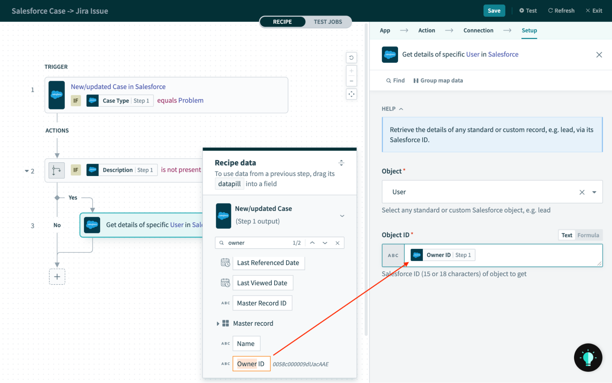

Now we need to create actions in our IF block that will alert the issue owner to provide the missing description (i.e IF condition is true). First, get the details of the issue owner from Salesforce.
The details returned by Salesforce include the issue owner’s email address. We can use this to look up their Slack ID.

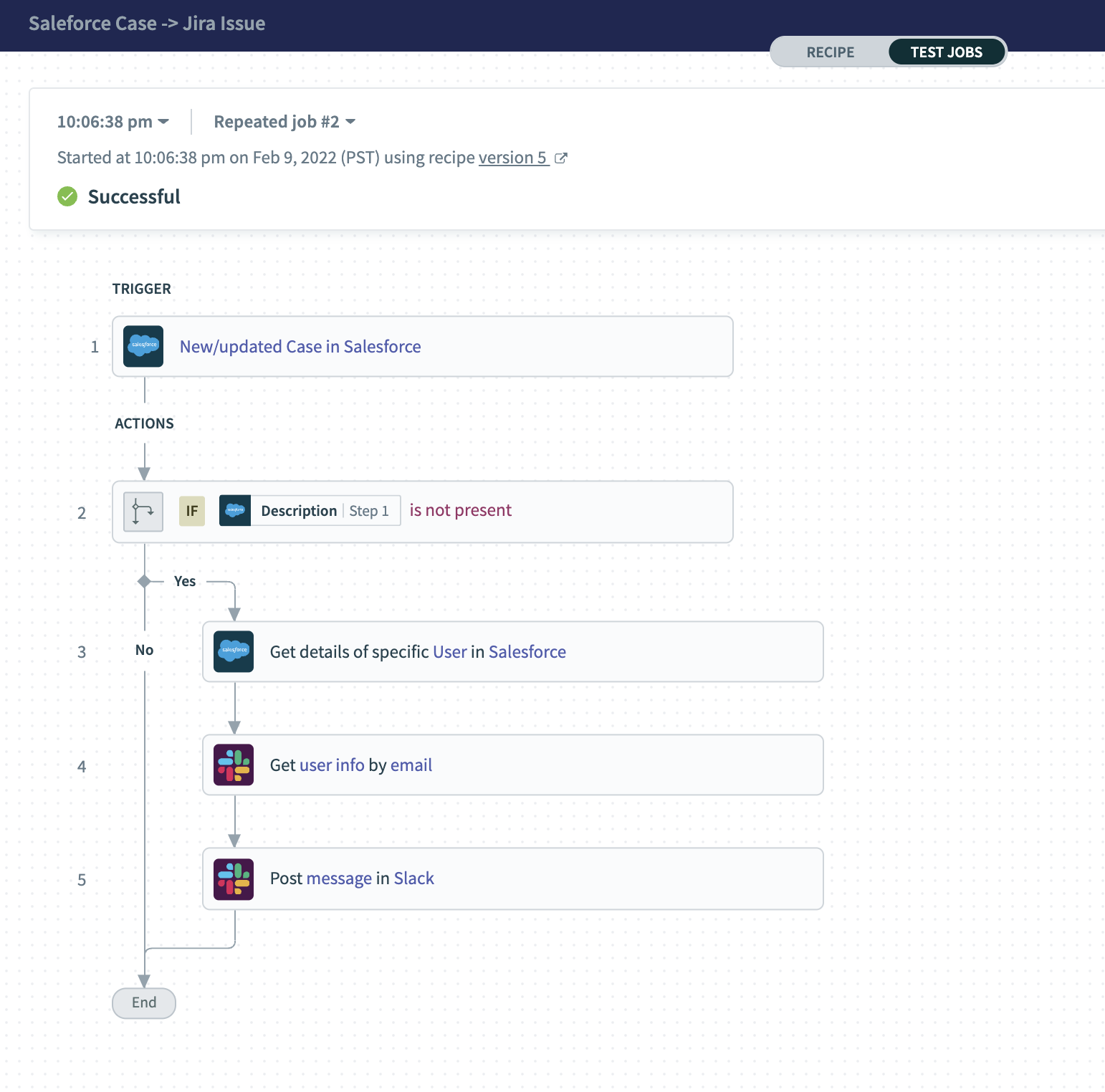

Set the recipe to Test mode, then create a case in Salesforce, but leave the description field blank.
You should see that your test succeeded, and your IF block executed.
![Successful test job with IF condition executed](https://www.workato.com/product-hub/wp-content/uploads/2022/02/image11-2.png)

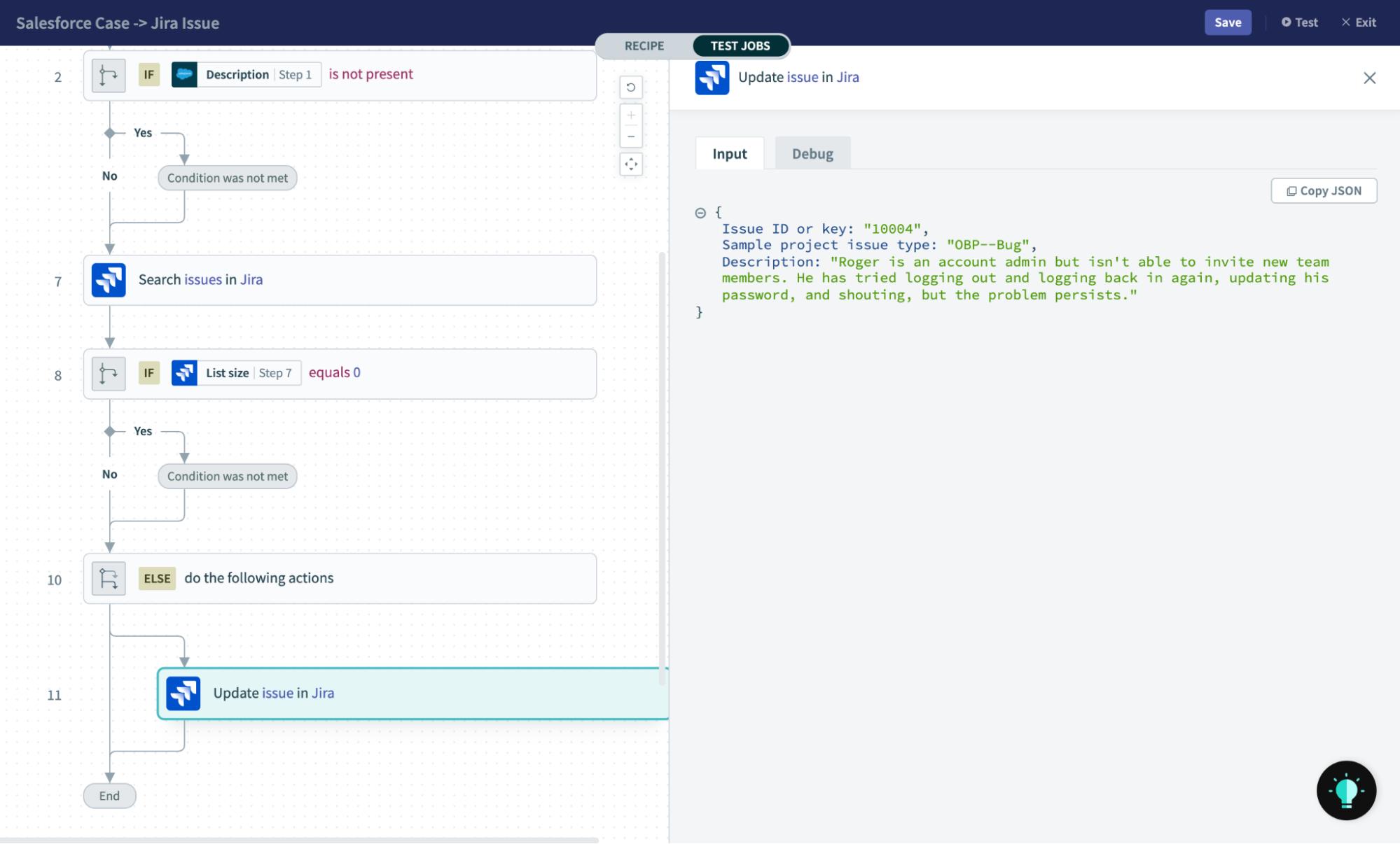

Now we need to test the ELSE half of our description. To do this, we can update the existing issue. Our recipe should detect that a matching issue record already exists, and update it, instead of creating a new issue.
Return the recipe to Test mode. Then make an update to the case in Salesforce, such as adding more information to the Description field.

Your test should show that your IF condition was not met, so the ELSE block executed, updating the existing issue in Jira.
![ELSE block executed](https://www.workato.com/product-hub/wp-content/uploads/2022/02/image3-2.png)
ELSE block executed — update issue in Jira
