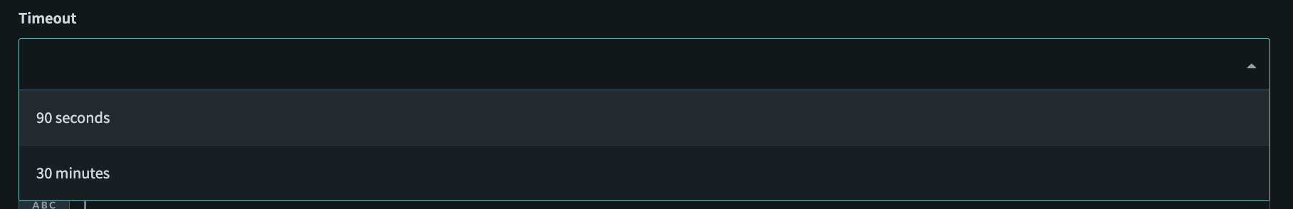

  • The timeout can be extended to run this call asynchronously if the execution time is more than 90 seconds.
Timeout
